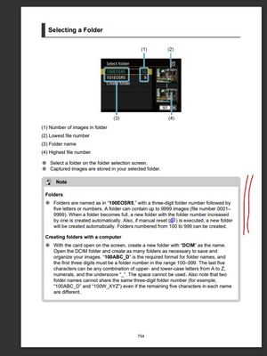

Here is a page from your camera manual:
 I did check in your manual and see that the R5 lets you create your own file prefixes. Here is what I do:
1. My file prefix starts as 1D30 (my camera is a 1D X Mark III)
2. My camera is set for continuous file numbering.
3. I when my file count nears 9999 I change the prefix to 1D31 and reset the file counter.
4. Now my files are 10001 through 19999.
5. I repeat again when numbering approaches 9999.
6. When I import images I use the renumber tool in Canon DPP4 for final file numbering. I use: 1DX3_xxxxxx (previous cameras would be 1DX1, 1DM4, 1DM2).
