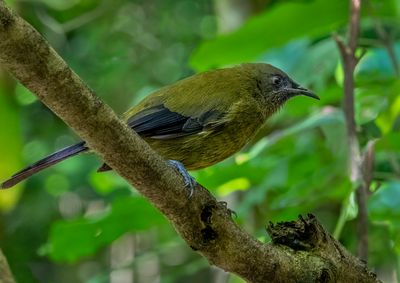

I use single point centre focus with eye tracking and servo mode.   What I do is point to the part of the bird I want to get in focus and use Back Button Focus (thus taking the shutter button out of the process) to lock on the bird .   From there face/eye tracking has a much better chance of locking on what you want - holding down the AF-On button will track dynamically with the point of focus.  If I lose focus, I can reposition the focus point in the centre by pressing the SET button inside the main wheel.
The following images were taken with that methodology: in the first image, the eye of the Red Panda is barely visible between moving branches and leaves, while in the second, the conditions were very, very dim and lacking in dynamic range - and of course the Bell Bird was camouflaged to blend in.
Red Panda@10m: R5, RF 200-800@ 600mm, f/9, 1/500sec, ISO-6400Red Panda@10m: R5, RF 200-800@ 600mm, f/9, 1/500sec, ISO-6400  247mm, f/5, 1/125sec, ISO-3200247mm, f/5, 1/125sec, ISO-3200

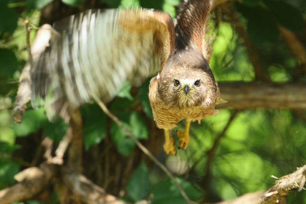

Red-shouldered Hawk (Buteo lineatus) in Norman, Oklahoma, United States on May 21, 2024Red-shouldered Hawk (Buteo lineatus) in Norman, Oklahoma, United States on May 21, 2024

You are a brave man shooting birds directly over your head!   I was out with a Canon sales guy demonstrating the R3 when it first appeared and, like you, shooting directly overhead at gannets doing aeronautical manoeuvres above when not one, but TWO large gannets unloaded a LOT of 'surplus digestive material' (so to speak) directly across them, scoring direct hits on the upturned cameras, heads clothes and bags.   Luckily they had cleaning materials and lots of cloths to hand to clean things up.
I was lucky that I had moved a wee bit away to do some other shots so I was not impacted and glad to be so!

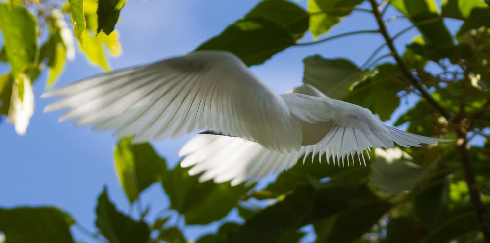

Hoping to get more shots like these (this is a screenshot I texted to a friend):
Truly appreciated!
