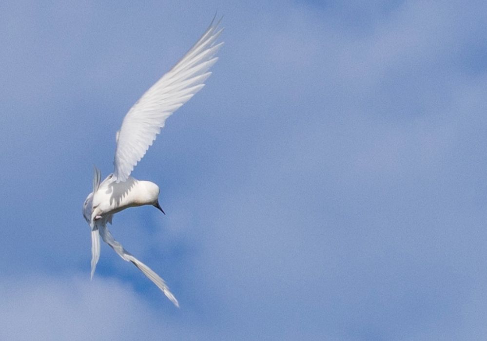

Hoping to get more shots like these (this is a screenshot I texted to a friend):
Truly appreciated!

As for aeronautical manoeuvres, thought this was a fun one! Screenshot:
Mahalo for your help!
