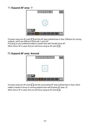

I would use 1pt AF or one of the Expand AF modes. I would enable WAT, Whole Area Tracking. If not, then will revert to basic instincts and track the nearest target to the camera.

I misspoke.  I use Servo AF, not AI Servo.  I have never used Expand AF Area.  Forgive me for being a little dense here, but it will track a subject once it focuses on something?
sdecker,
No. To the best of my knowledge, single point or an Expanded Area don't do any tracking, but in Servo Mode,  it will keep focusing as long as you hold down that AF-ON button, or whatever button you have assigned to do your focusing. It will focus on whatever you point your camera at.
If you let go of the button, the camera will be focused, but it stops searching.

The others have suggested to only use a single AF point. I am going to recommend one of the single AF point modes with the surrounding assist points. These modes are less demanding on the skill required to keep the AF point on moving subjects. But, if you enable WAT, the camera should do a decent job of tracking a single horse. It might help to set up the AF-OFF button for AF resets.
“ No. To the best of my knowledge, single point or an Expanded Area don't do any tracking, but in Servo Mode,  it will keep focusing as long as you hold down that AF-ON button, or whatever button you have assigned to do your focusing. “
Yes, they will track when WAT is enabled.  Pretty display, too.

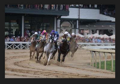

“ For now, I would advise you to disable Subject Detection and Eye Tracking.  I am getting the impression that you are too far away for those features to be effective.  Take advantage of the camera AF System instinct to lock focus on the closest object within the field of view. “
 That is from the first link you posted. Is this a good or bad example. You are probably too far away for eye tracking to be effective. Besides, the horses eyes are mostly covered. I guess that probably protects against flying dirt and debt.
Judging from the apparent distance, and the aperture of your lens, all the lead horses should be in focus. But they may not look very sharp if zoom in on the heads.
Have you checked to see where your locked SF point is located?
This is a good example.  It was shot wide open at 7.1, and if you zoom in all the way, the front horse's head is in focus the most.
Waddizzle
“ This is a good example.  It was shot wide open at 7.1, and if you zoom in all the way, the front horse's head is in focus the most. “
I would agree that this photo captured well. I assume that if the aperture was f7.1, then the focal length was 500mm.
I am not sure what could go wrong with other photos, except that you missed focus for some reason.  You, not the gear. The depth of field at 100 feet away is around six feet.  Not e very horse in the pack will be focus, just the lead hirse(s).
Have you checked to see where your locked AF point is located? You cannot claim the gear locked Dixon the wrong horse if you have not checked.
