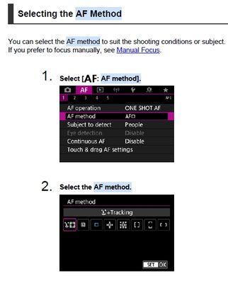

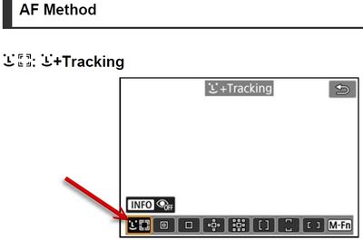

In our R5 classic, it's in a couple of places and is denoted by the "smiley face+tracking" selection and included in the "AF method" options.
This is what you will see by pressing the "Q" button, then tapping the AF method (AF point/area selection). This is from an old screen shot so that row of AF points/areas is along the top now, f/w ver. 2.2.0, but it may be a configuration thing 🙂
The other way to get there is in the AF 1 menu.
I use this, along with some servo changes, subject detection, and eye detection, to shoot BIF and flying insects. I store it in C1.
