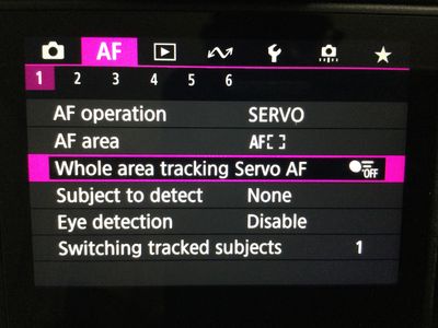

When you focus and recompose in Servo some interesting things can happen when Whole Area Tracking is enabled.  Start here, but enable Whole Area Tracking.  I think of this setting combination as DSLR mode.
Notice how the screenshot shows Whole Area Tracking disabled.  That’s DSLR mode for One Shot AF.  Enable it for Servo mode, and the camera will track your subject across the frame as you recompose.
The crucial step to making this work is to define an Initial AF Tracking Point. Select the Single Point AF and chose the center. Go back in and select the entire screen area to display the icon in the screen shot.
Now try a focus and recompose with Tracking enabled. A cluster of AF points should remain on the subject as you recompose, providing that you maintain a half press on the Shutter.  You will see the same behavior if you use BBF.
When you enable Subject Recognition and Eye Tracking, those clusters of AF points change from a cluster to a dynamic bounding rectangle.  With Eye Tracking enabled, a small AF box will appear over the subject’s eye.
