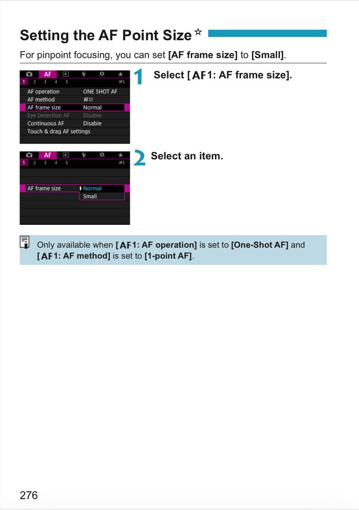

If Spot AF is unavailable, then which AF point mode are you using?

1 point small

@BryanShaw1 wrote:1 point small
“A rose by any other name is still the same.”
That sure sounds like Spot AF, to me.

I just performed an area check on the EOS R AF options (it's easy. just shoot a metal mm scale at about 8 feet away) for the "1-Spot Normal" and "1-Spot Small" settings on the R.
1-Spot normal = 7.35% of the frame width and 1-Spot Small = 4.4% of frame width, Sooooo... the the relative angle of the AF zone on a EOS-R in the 1-Shot Small setting is actually slightly smaller than that in the R-5 "Spot" mode!!
Waddizzle is correct: “A rose by any other name is still the same.” In fact, the old EOS-R rose may even smell a little better.
