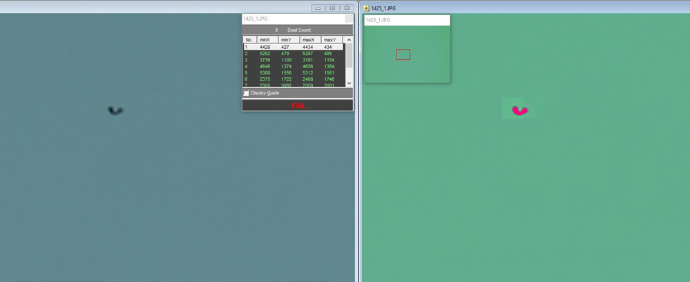

Canon R6. Just received a message from Canon after sending my body in for CPS free clean and check up and they say that I have scratch on the sensor. I have combed through my images and can not find one example of this being the case. Has anyone else had this issue? They seem to want me to upgrage/trade in to the Mark ii which I'd love if I had the extra case around. Also, the repair to the sensor is $779 labor and $1200 for sensor making the trade in cheaper than the repair.
I have posted a straight out of camera image as well as the image sent by Canon. Can anybody spot the spot... so to say?

I'm not clear what you're showing us? One of the images is a picture right out of the camera and the other two below are?
Are these pictures of the sensor that show an anomaly or scratch?
If you're not seeing any issues, there's no reason why you can't continue using the camera. If it becomes a problem, you can purchase a refurbished mkII for less than the anticipated cost of repair.
I'd walk away from the body if It needs a replacement sensor and you don't have a CarePak.
