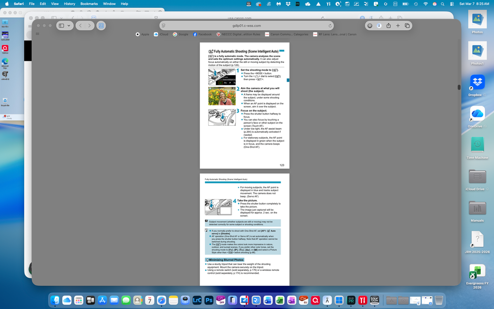

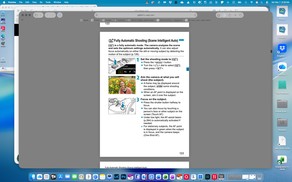

Since your camera has a Mode LCD display instead of a Mode dial here is what you want to try:
Close-up:
This setting will temporarily override many settings that the previous owner applied.
