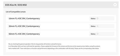

If the lens you are using is the 18-35mm F1.8 DC HSM | Art model, which is an 11 year-old unit, then my suspicions are going in the direction that this lens may not be as compatible to the M50 as your other optics.  Again, it does not necessarily mean it is a complete mismatch, but you may not perform 100% as you might want it to. Have you checked with the Sigma folks to see if they have had similar issues reported with this model of camera?
I checked with the Sigma website and this lens is not listed as being compatible with the M50.
Camera Compatibility | Support | SIGMA Corporation (sigma-global.com) Now, this very short list may simply be an indicator that they just didn't test it - there are a lot of possible permutations here, but it does not mean that one can take it for granted that the lens does work either.
