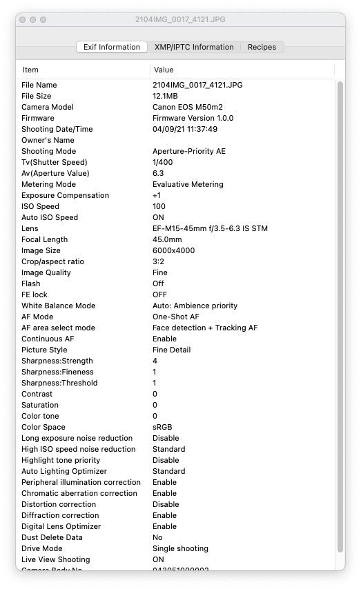

I downloaded your larger image and it has been edited, so I cannot read the detailed camera settings using Canon DPP software. Here's an example of the detailed settings I can see for an EOS M50 Mk2 JPG image straight from the camera.
This is what I see from your image.
If you can give us a screenshot like this from your image then it makes it easier to help you.

So io can give screen shot but ur dont understand bacause it on my native language and i dont know how to make it english. but a can tell the what is the af settings (AF.mode one shot, Face detecting + Tracking AF, continuous AF - enabled)

I'm guessing that the face of the model is not in sharp focus (but the background is) because teh AF area select mode is "Face detection + Tracking AF" per the EXIF data.
Again, my guess  is the the "Tracking AF" was hunting and focused on the background instead of the face and eyes.

Here are the full details for the RAW Image, as shot:

Thanks for the RAW file NickSlav, and to zakslm and Trevor for the decoded info.
I don't see anything in the EXIF that would point to a camera settings error. I have two thoughts;
  1. Maybe the camera and lens don't work together well. Even though the lens works well on other bodies, maybe there is some body specific issue with this combination.
  2. With the camera set for one-shot AF and the AF area set to Face detection + Tracking AF it is possible that the model or camera moved after the AF locked, but usually I'd expect to see much less of a focus difference.
  3. Turn off preview AF, it might be called continuous AF in the camera menu.
