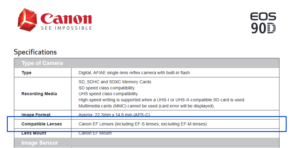

Canon specifications clearly describe lens compatibility for the 90D. Your user manual will show this information as well.
https://downloads.canon.com/nw/camera/products/eos/90d/specs/eos-90d-specifications.pdf
If you feel you got a fair deal and the 90D otherwise meets your requirements I'd say keep it and go shopping for EF or EF-S lenses.

Your 90D, being a crop-sensor DSLR model, can use ANY EF or EF-S lens ever made. Full-frame EOS DSLRs, and film, cameras can only use EF. It's that simple. Cannot use EF-M or any other lens not EF or EF-S. No adapters to do it. Nothing.
