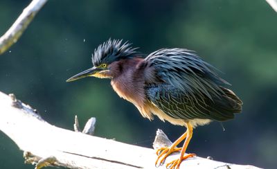

99% of the time I'm taking photos of birds, and even when the bird stops in one place, its body moves a little bit. So I tried many methods, still need to switch between the two AF. Please look at the night heron I took this morning.
06-23-2023 02:35 PM
This green heron is throwing a tantrum, its feathers keep changing, I have to quickly switch to AI Servo mode to shoot it.

" I have to quickly switch to AI Servo"
No you don't. That is not what Ai-servo is designed for. Your two bird shot are good One shot examples. Ai-servo is designed for a constant motion like a race car going in a horizontal motion across the frame. It is not for flickering feathers!.
