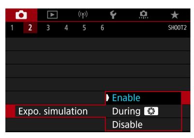

Okay, so one of my uni lecturers changed the settings on my camera and I don't know how to change it back.
I've always had the exposure simulation on but I cannot for the life of my find it anywhere in my settings and I can't get a hold of him as we are on Easter break.
I have a Canon 90D, please any help would be great!!

Greetings,
Camera Menu > 2 > Expo Simulation

Hiya,
I have tried that but unfortunately I don't have that option:( this is why I can't understand it as that's what comes up when I Google it.

What mode are you using. Exposure Simulation is ON by default from the factory. I believe this setting can only be changed in the creative zone (M, Av, Tv & P) modes.

I always use Manual.

Were you able to check that setting to ensure Exposure Simulation. If not reset the camera back to factory default. Including resetting the custom functions back to factory default.

You need to be in Live View to get the option in Menu
