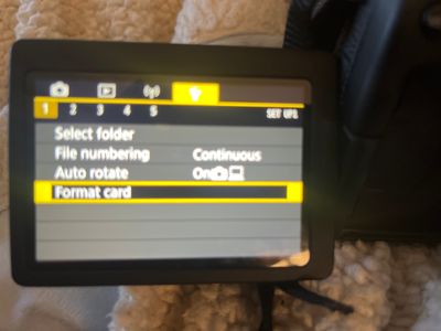

Stephen
I have a eos 90d. When I look in the manual on how to clear camera settings it says to go to the menu and choose that option under the wrench, however, there is no option for clearing settings and I looked through all five pages.

You typically have to put the camera in at least Program (P) mode if not Manual (M) mode to have access to more menus.

The default reset option that appears does not fully reset the camera.
Some menu options have their own sub-menus complete with their own reset option. A good examplle of this would be the Custom Control menus. There are at least a half dozen, or more, sub-menus that have their own reset option.
