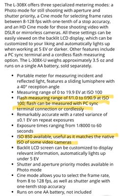

You say
"But ISO isn’t exactly an exposure setting. Exposure is set by shutter speed and aperture. Film cameras did not have an ISO setting. You could only control shutter speed and aperture. You changed the sensitivity of the camera to light by changing the film in the camera.
ISO is just an electronic substitute for the different slim speeds that you could buy when people were shooting with film. Light meters do not have an ISO setting. They are designed to report exposure settings when used with 100 ASA film, which is the sensitivity that the digital setting of ISO 100 tries to simulate."
What are you talking about? Of course film cameras have ISO settings (unless they get the ISO speed from the film cannister DX codes), and of course light meters do. How else could they determine proper exposure settings? I don't believe you actually said this.

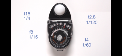

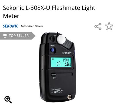

“ What are you talking about? Of course film cameras have ISO settings (unless they get the ISO speed from the film cannister DX codes), and of course light meters do. How else could they determine proper exposure settings? I don't believe you actually said this. “
Believe it.  A light meter will only provide Tv and Av values.  Some film cameras used ASA values to compensate the metering system.  But the exposure settings on film only allowed you to control Tv and Av.
This analog meter is capable of recalculating the values using the exposure triangle by turning a dial called ISO.
This more advanced digital only provides Tv and Av values at ISO 100.  It’s left up to the user to determine Tv and Av values at other ISO values.
You are contradicting yourself. The first light meter you show DOES HAVE an ISO setting dial. You said it yourself. How do you think it's giving Tv/Av results for varying light levels?
A light meter or camera that gives Tv/Av for different available light levels must have an ISO setting. If, as you say, a meter can ONLY give exposure values based on ISO 100, leaving it up to you to figure values for different ISO, makes no sense.

“  If, as you say, a meter can ONLY give exposure values based on ISO 100, leaving it up to you to figure values for different ISO, makes no sense. “
I guess the light meter example makes no sense, either then.  It only provides Tv and Av values based on ISO 100.  It’s left up to the user to recalculate exposure (Av and Tv) for other film sensitivities.
Beliveve it.  ISO isn’t really part of exposure.  Your camera allows for mechanical control of just Tv and Av. These two parameters are all that control exposure.
The analog meter is capable of recalculating Av and Tv for you.  But the only exposure information the light meters provide is Av and Tv.
