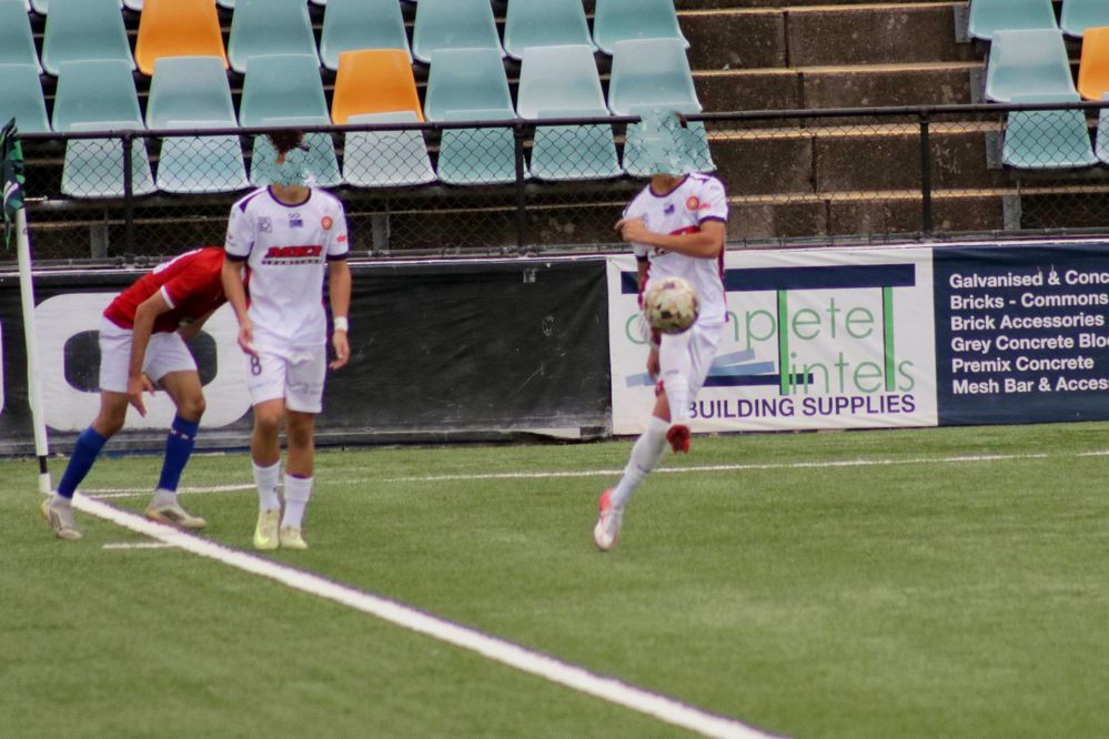

Previously with the 30D i used Av mode, ai servo, high speed continuous burst, adjusting ISO 300 - 800 depending on sunlight. i find on 80D these settings result in a very dark image so now i use Tv mode, auto ISO, ai servo, high burst
The focal point area selection is much more complicated on 80D so was hoping to find out which of the 4 templates of focal points to select and what areas to of the template to highlight.
For the photo uploaded i used the single focal point template aimed low to avoid the banners
