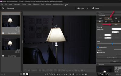

I suspect that with DSLR's it is a live view feature only, as you have found, because what you are seeing through the VF is just through the lens and unprocessed like it is in live view. My MILC's show the ratio in the EVF because they show you what the sensor sees.
When shooting through the VF: I'm not sure how it works with anything but DPP, which is my primary raw editor, but on my DSLR's, I leave aspect ratio in the shooting menu at 3:2 and select the ratio I want in the C.Fn4 menu (on the 7D II) "Add cropping information". This will bring it into DPP at the ratio I pick. You can get the 3:2 back by clicking the "Clear" button.
When in LV: I set my ratio in the shooting menu. It comes into DPP just like as described above and I can leave it at that ratio of clear it back to 3:2.
This is a screen shot from DPP 4 with the cropping info added as described above. I used 6:6. You can add a grid if you like and resize your ratio.

This is the same shot from the 7D II with the aspect ratio cleared.
