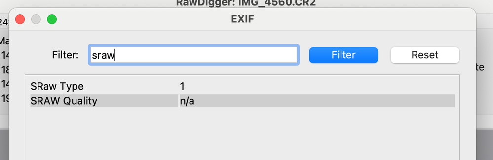

Some RAW files from my EOS 800 don't work with Lightroom Classic denoise feature. What I found in Lightroom is that denoise doesn't work with Canon S-RAW file types. Here's the adobe website.

I had to go to Rawdigger to find out the files were S-RAW. Where does this get set in the menus? Mosaic Data shows as YES when I check the metadata on the DNG file.

I get that's why the files are not working with Lightroom denoise feature. What I don't get is where in the menu is that set, and how do I get back to straight RAW?

02-13-2024 05:53 PM
That's interesting, because Dawdigger says the file is an SRAW. If I can't set it, what is going on?

It is an 800D. So if I can't set it, what is Lightroom complaining about? Mosaic = yes, so it should be a full file.
