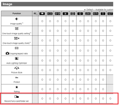

I did more research.  I think it might be possible with *limited application based on this:
See here:
Canon : Product Manual : EOS R5 : Custom Function Setting Items (start.canon)
