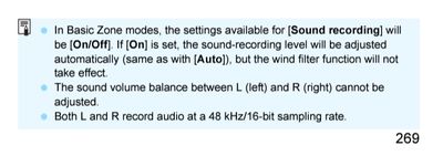

@Ry3 wrote:So on the canon 70d - The sound recording option- on this particular camera gives options of ‘on’ or ‘off’ - every other canon I’ve worked with, and I own 3 70D’s, the options are ‘auto’ and ‘manual’ I need ‘auto’ and ‘manual’ to hook up my sound gear properly. On or off doesn’t get me anywhere. I can’t see anyone having this issue on line so I’m striking out as to how to fix it. Any ideas?
Double check the mode dial and make sure you are not in one of the "Basic Zones".
From page 269 of the 70D users manual.
