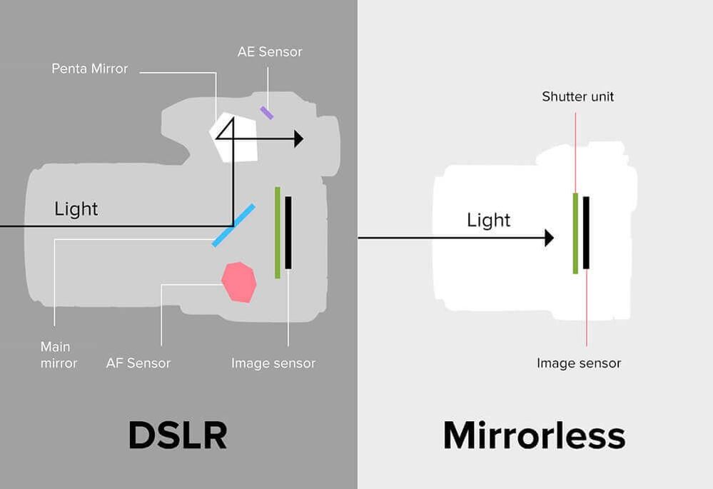

Are you sure you have the EOS 6D Mark II and NOT the EOS R6 Mark II. The EOS 6D Mark II DOES NOT have 2 card slots so please confirm your camera model. Also what lens do you have attached to it please provide the full name and mount adapter if used. Saying "Canon 24-105mm" isn't a complete name. Canon has made multiple lenses with that name. If it was as DSLR the viewfinder is optical and as long as a lens is mounted and the lens cap is off. You should see everything through the lens. A mirrorless camera doesn't work this way. The viewfinder is ELECTRONIC and it requires power for it to work because the EVF gets a live feed from the image sensor. A DSLR used a reflex mirror to bounce light up to the view finder. This system doesn't exist in a mirrorless camera. Which camera is yours below also I've provided examples of lenses so you can find the full name of the lens you have.
