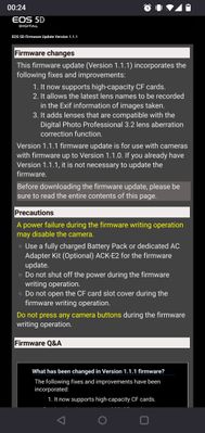

Peter
5D needs firmware 1.1.1 to be able to use larger CF cards
