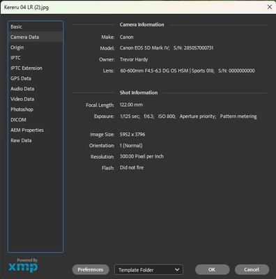

I am no printing expert, but when I look at the file specs you published, the thing that leaps out to me is that it is at 72ppi. The 5DIV can generate images that produce 300ppi, so there is a setting re resolution that needs to be reset, either in camera, or in your post-production software.  I would recommend shooting in RAW and, if necessary hi-quality JPG file formats.  Process the RAW image for printing.
For good prints, conventional wisdom says that you should be generating 250-300ppi - to me, that is why your printed images are not sharp. For example, the following image is a JPG file at 300ppi:Kereru 04 LR (2).jpg
Even reduced to <9MB file size, it still retains the density of 300ppi.
Now, ppi is not the same as dpi - the latter is the ink dot density the printer will produce, but it has to have the resolution density in the image to begin with, so you could have the best resolution printer in the world and if the quality of the image is not up to it, then the print will be fuzzy.
cheers, TREVOR
