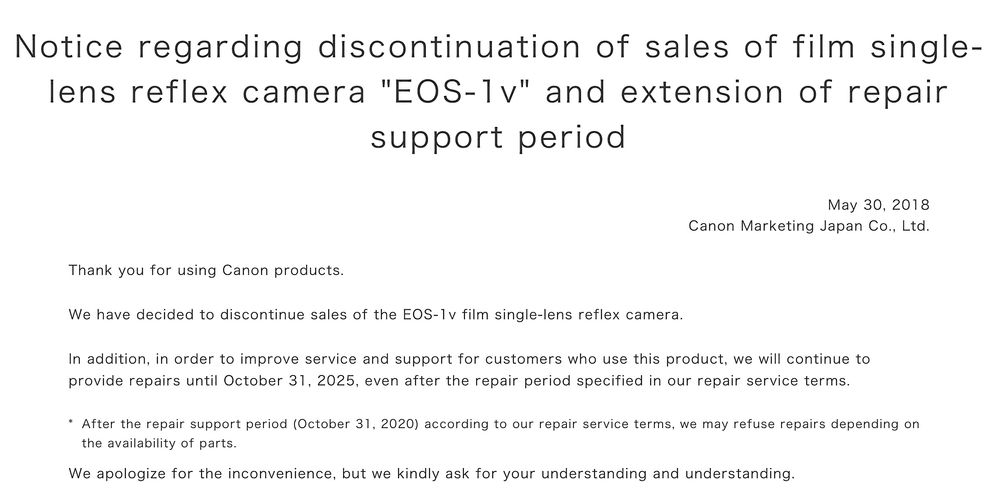

When Canon discontinued the EOS 1v in 2018 it promised to service them until 2025.
”According to Canon’s statement, it will repair existing EOS-1v units until October 31st, 2025, although repair requests may be denied after October 31st, 2020, depending on remaining parts and inventory.”

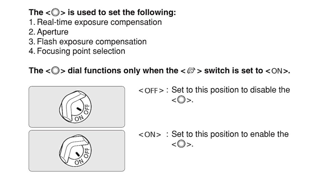

If you have only used Manual mode, make sure the Quick Control Dial Switch is set to ON.
(we have all done it at least once)
09-10-2023 09:18 PM
Oh my gosh. Smh. That was it. I was so nervous bc of the autofocus issue I had right before this. Thank you!
