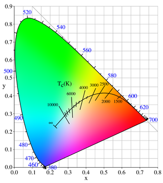

A 2 dimensional version of Kelvin line:

The "tint" in question appears to me to be labeled "hue" in camera menus, in DPP, and in the Canon style editor. It provides adjustment along a second dimension on the color model and lightness or saturation would be the third dimension depending upon whether HSV or HSL. Changing the hue will change the apparent tint.
At best, temperature Kelvin describes the peak of a distribution and not the shape of the distribution nor is place in the 3d model.
