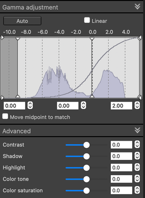

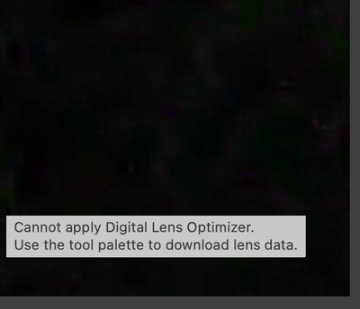

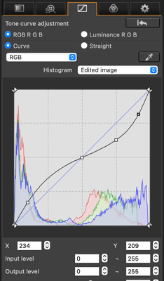

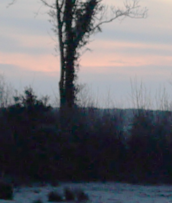

I hope some of this might be helpful.
In the metadata, I noticed "[MakerNotes:Camera] PeripheralLightingSetting : On". I turned it off in DPP and this is the bottom right corner after brightening at 400% and I do not notice much noise:
This is one of the trees at 400%:
Thank you, I guess that is normal with Canon R6 II sensor.  It is just the Lightroom CC that made the RAW files look worse.
