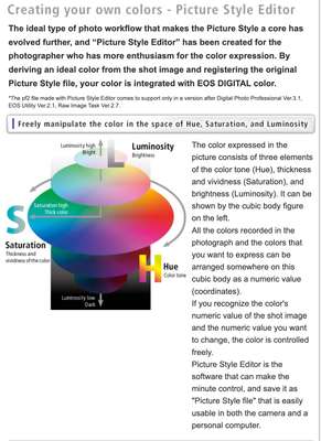

You might create and register up to three custom picture styles using the picture style editor and the EOS utility.
The picture style does not contain the color temperature in Kelvin, because at least two dimensions are needed to characterize color. The picture style allows changing contrast, saturation, and "tone". The Picture Style Editor also allows changing the shape of the tone curve.
Color temperature in Kelvin describes a point on a line through the color space.
Picture Style Editor allows adjusting hue, saturation, and luminosity in a 3 dimensional color space. Kelvin would be one line through this 3 dimensional space. https://en.wikipedia.org/wiki/HSL_and_HSV
In the past, I have photographed a standard gray and used that to create a custom white balance for particular lighting. This seems to me the easiest, but does not give control of all dimensions of the color space.
https://en.wikipedia.org/wiki/Color_temperature
The Canon picture style editor seems to me to use a different model of color space.
https://global.canon/en/imaging/picturestyle/editor/index.html
