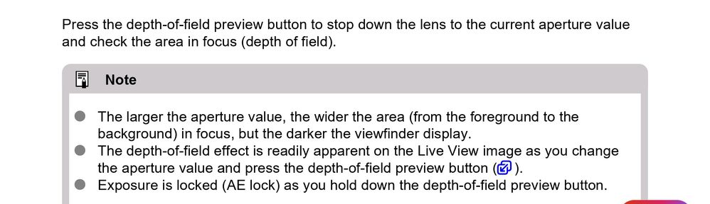

12-13-2025 10:07 AM - edited 12-13-2025 10:08 AM
From my T8i manual:
Theoretically, I suppose this could be expressed as a range of numbers instead of areas of smaller or larger areas of darkness.
Steve Thomas
