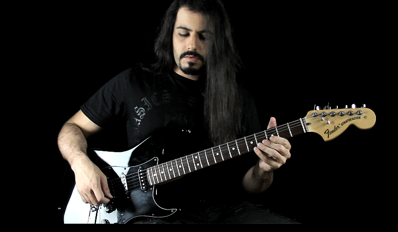

Yesterday I shot some videos with my 7D and after downloading the videos to my laptop I noticed every movie starts with the correct color temperature and after a few seconds the colors seem a lot hotter.
Does somebody knows why this happens and how can I prevent that?
Here are some facts:
* I was using Live View so I could trigger movie recording remotely from my laptop (I was shooting alone).
* I recorded SEVERAL takes within a period of 4 hours, each take lasting about 2 minutes, and waiting about 1 or 2 minutes before starting recording the next take (sometimes I started immediately). I kept just the very last ones, so I don't know if this issue was happening during the first takes. Could this problem be related to camera sensor working for hours straight, even taking a break of 1 or 2 minutes between each take?
* Light sources remained constant during the entire recording session.
Below are some screenshots so you can see what I'm talking about:
Thanks!
AT THE START OF THE VIDEO:
AFTER A FEW SECONDS (notice how skin tones changed drastically):

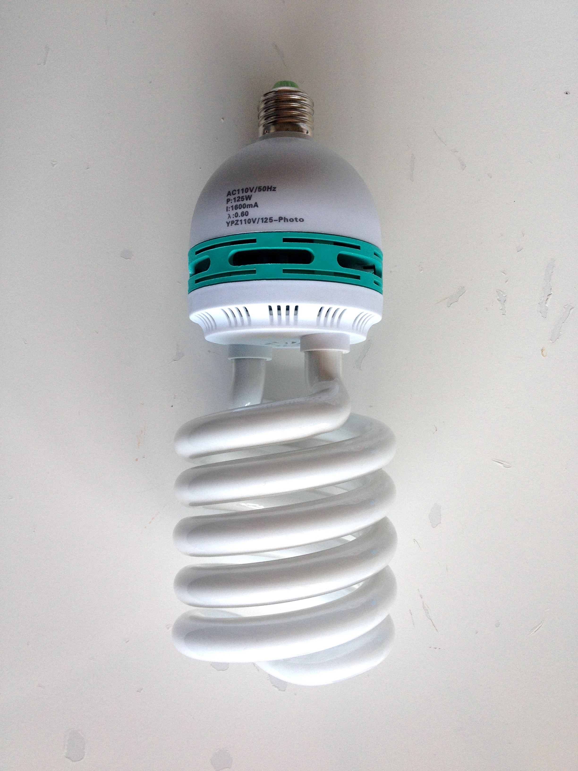

What is the light source?
03-23-2017 01:37 PM
03-23-2017 02:02 PM
Tungsten, flourescent or led?
03-23-2017 02:59 PM
It is fluorescent:
03-23-2017 03:38 PM
The flicker is probably faking out the auto white balance, or the flicker is not syncd with the video.
