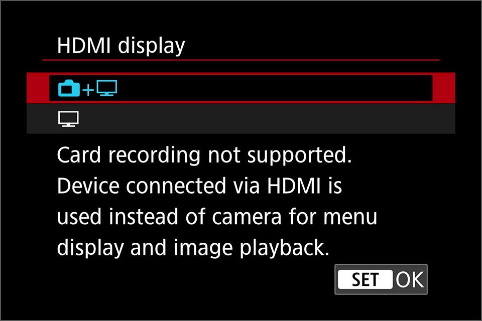

I'm using this setup with my EOS R10 / R6 / R6 Mk II and an ATEM mini myself.
With the EOS R50 camera in movie mode, go to the SHOOT6 menu, (6th page of red tabbed shoot menus) then find the setting for HDMI display. Change it to the first menu item so that the camera LCD / EVF is on and the HDMI output works.
Here's the screens for my EOS R10 - which is very similar, except the HDMI display setting is on the 7th page.

But we can't record in SD card, right?
 due to this..
You are correct, it is not possible to have clean HDMI and record to card. This is what the text says on my second screenshot and your photo.
