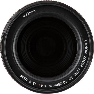

Hi @WSC33 welcome to the forums. What lens are you using. Are you adapting older EF/ EF-S lenses. If so what mount adapter are you using. 3rd Party mount adapters cause all sorts of problems. Or are you using native RF lenses. Just know not every EF lens released can utilize all features found in R series cameras. Especially older EF lenses. Please provide the Full names of all lenses that are being used. That includes the mount adapter if one is being used. I have example pictures below to help you identify your lens model.
