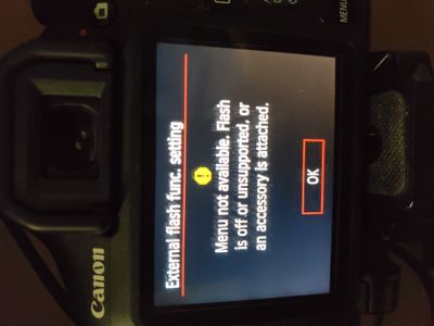

05-27-2023 01:43 PM
thanks for the reply.
Yes when i go into the menu it says unsupported
Do you know of a canon trigger that has a 3.5mm sync cable port that would give me menu access?
My external flash only has the sync port and no hot shoe. T6 doesn't have a dedicated sync port other than the hot shoe.

It seems like I need to get into the camera settings to turn off wireless triggering? I can't get into the settings because it's not compatible?
