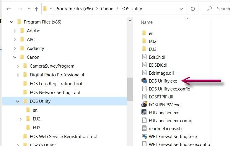

It should be here:
Windows Path to EOS Utility.

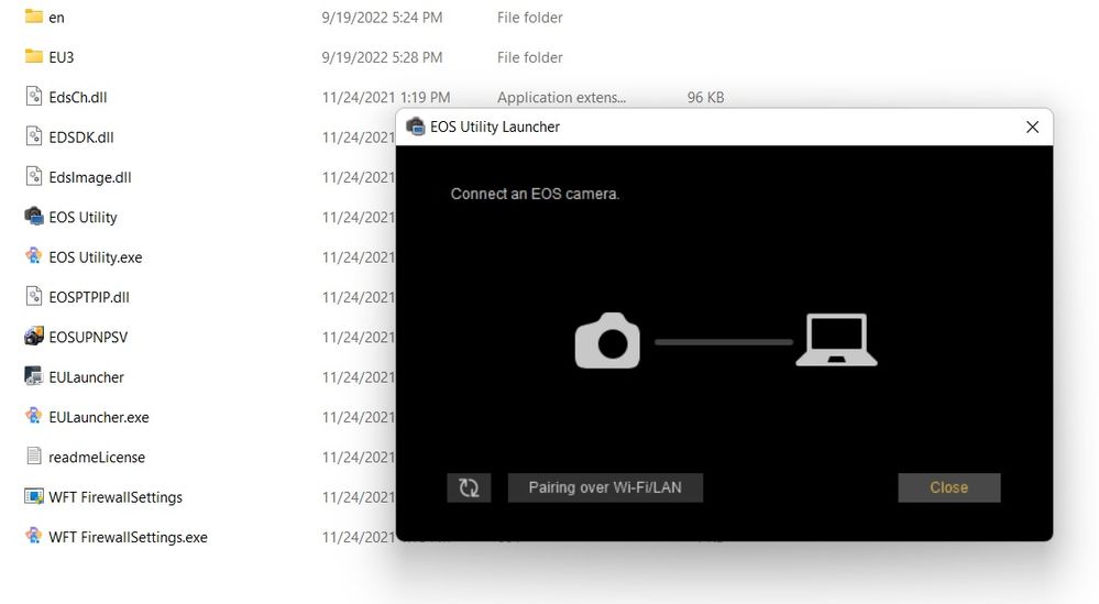

When I try to run that as administrator, all I get is this Eos Utility Launcher.jpg

Sorry if this is a stupid question, but do you have your camera plugged in via USB when you try to start the app?
09-26-2022 02:46 AM
Yes i do. Plugged in with USB, turned on and connected to power source
09-26-2022 02:48 AM
Could this be a result from potentially the USB port in the camera not being functional or broken?
09-26-2022 03:35 AM
Go into the camera menu and make sure Wi-Fi is disabled. I suspect the correct program is in the “EU3” folder.
09-26-2022 06:18 AM
Duh! You should also check the Start Menu for EOS Utility 3. Should have told you to look there first. IF the Installer is no longer installing EOSU 2, then maybe they correct the issue with a shortcut for EOSU 3 not being added to the Start Menu.
