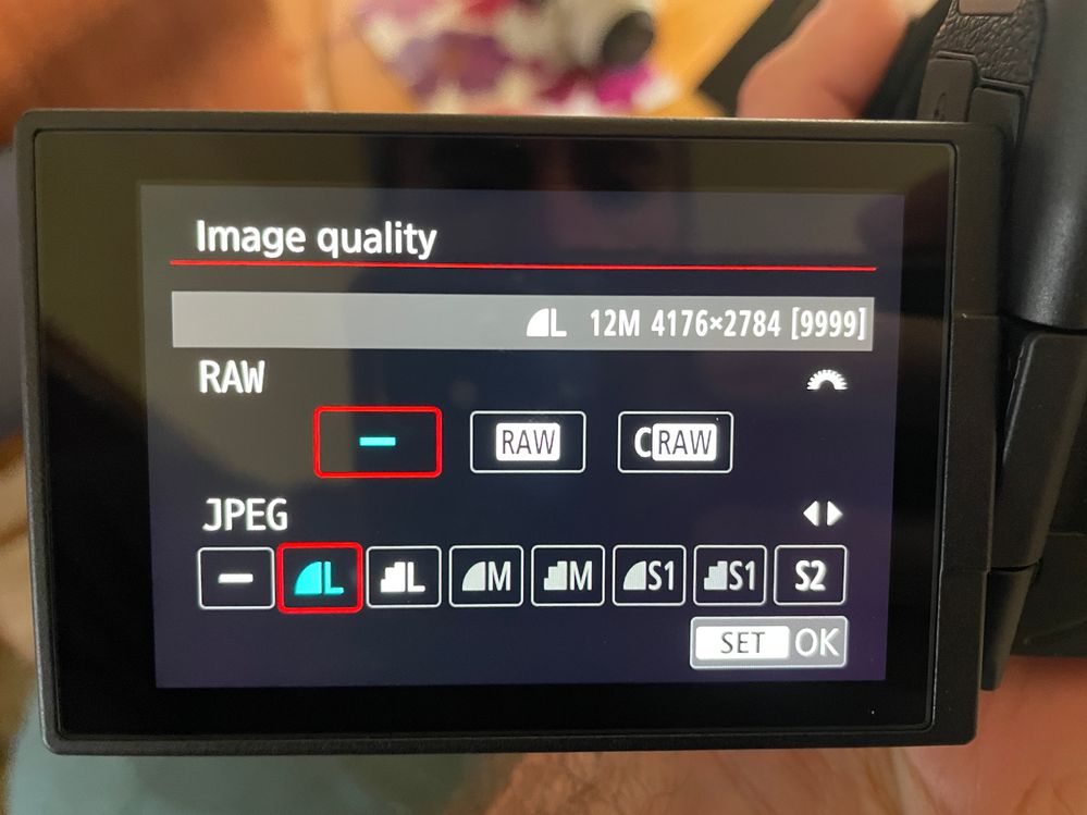

IMG_3017.JPGIMG_3019.jpgIMG_3022 12mp max.JPGI have an R with an 2.8 Canon EF-S 17-55mm f/2.8 IS USM
the 50fps is greyed out so can not select it
memory card is v30 64gb 95mb so should be fine
Also is only showing 12Megapixals in photos mode!
Both in M mode
Any ideas?

Maybe the cropped image size with an EF-S lens is smaller than the cropped image size of the video with a full frame lens.

The EOS R series mirrorless cameras have restrictions when using EF-S or the New RF-S lenses. These lenses force the camera to operate in 1.6x crop mode. Due to the image circle being smaller than Full Frame. You will have a loss of megapixels when using APS-C lenses on a Full Frame body. They also don't allow the use of 50 or 60 FPS mode while in movie mode. If you Click here you will find the manual for your camera. Page 219 mentions restrictions on movie about EF-S lenses. Screenshot 2022-09-25 152841.png Screenshot 2022-09-25 153702.png

Bummer, thanks for the info, was waiting for canon to reply for days now, nice to know the community here is so active and helpful. Much appreciated. I’ve now bought a EF 24mm-105mm f4 is
