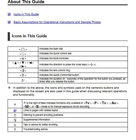

The user guide tells you whether a particular function will be available, they have a star in the upper right corner if that function is limited to PASM modes:
