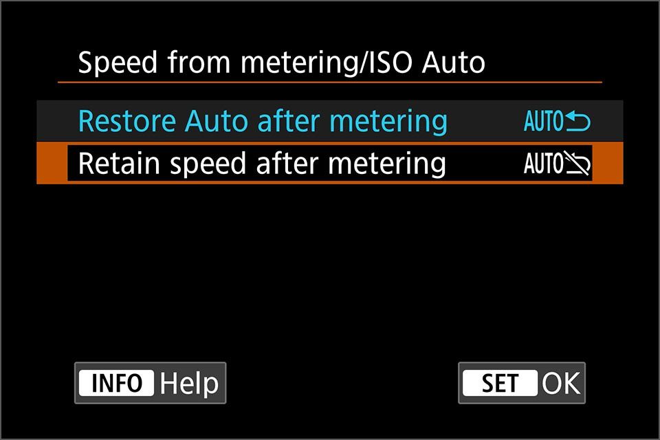

When the camera is set to auto ISO and you select ISO using the quick control dial you will notice that the selected value is shown, but next to it on the screen is the AUTO icon in grey not white. This is because the default behaviour for the EOS R6 and other EOS R-series cameras including the EOS R6 Mark II is to return from the selected ISO to auto after the metering timer runs out.
Please also note that when the ISO is set to AUTO and flash is being used, the mirrorless R-series cameras vary  ISO much more than the DSLRs. DSLRs generally default to ISO 400 with flash and auto ISO, mirrorless the ISO will move between ISO 100 and ISO 6400 to suit the ambient light.
There is a setting on the camera in the custom settings to change this new ISO behaviour to the same as your older DSLRs. Navigate to Speed from metering/ISO Auto in the custom functions, then change it to Retain speed after metering. See the screens below, the screens are from EOS R6 Mark II, but the same setting on the first page of the custom functions exists on the EOS R6.
