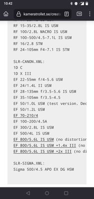

There are lens profiles for Lensfun if anyone wants. Just ask if you need one. 500mm in Exif = Sigma 500/4.5
