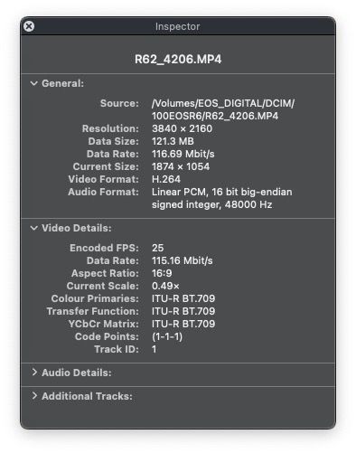

Open the video file in Quicktime player, then show the video inspector by pressing CMD I.
Here's what I see for two clips I recorded on my EOS R6 Mark II just now, but I also did the same with the EOS R10 which is similar to the EOS R50. The first clip is recorded with H.264 and easier to playback, the second uses H.265 and is the compression that needs some hardware support to work with. Give you said your MacBook is a 2019 model then you have an intel processor, as the M1 processor was a November 2020 launch.
This clip was recorded with HDR PQ switched OFF
This clip was recorded with HDR PQ switched ON
For the one with HDR PQ you see the data goes to 10-bit, REC.2020 and the format is indicated as HEVC.

Is it possible that you recorded the video with H.265 encoding, this is notoriously challenging to playback unless the machine has specific graphics card support or is a Mac with an M1/M2/M3 processor.

Thank you! This was indeed the issue!
