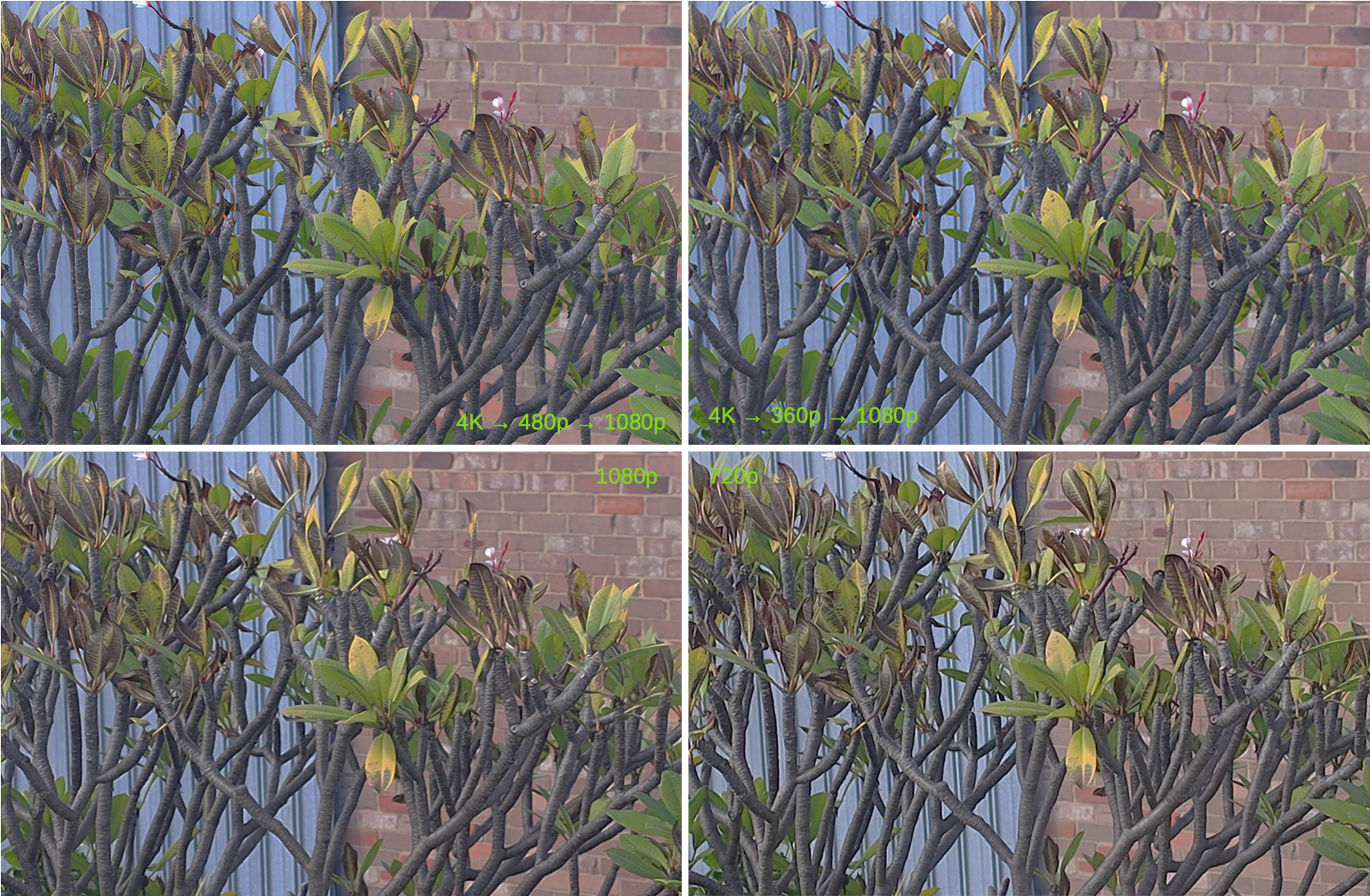

Canon 40mm/f2.8 (4f,1/640, 320 ISO) with EF->EF-M adapter.
Looks like 1080p video has the image quality somewhere between 360p and 480p.
720p and 1080p looks the same to me.
The prime lens didn't change the conclusion.
There is something wrong at the level of firmware.
I can believe that 360p downsampled from 4K can look similar to 720p captured.
But why 360p looks almost the same as 1080p???
Amount of pixels for 360p is only 10% of 1080p. 10 times difference, the same quality...
Whatever it is that you are seeing on your computer is not coming through on the forum images.  It never will, either.
