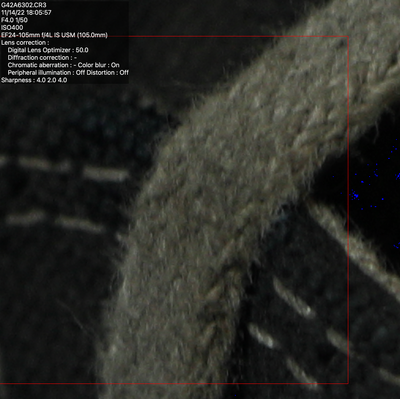

In Canon DPP, I disabled peripheral illumination correction, disabled noise reduction, increased digital lens optimizer to 50, and took a screen shot at 400%. The portion in focus seems to me to have a lot of detail. I guessed that the camera might be mistaking fine detail for noise and also maybe peripheral illumination correction results in more noise in the corners and I speculate that peripheral illumination correction enabled results in the camera creating a darker or brighter image. I left the unsharp mask alone, but increasing fineness to 4.0 or 5.0 would likely sharpen the areas that are further from the focus point that have more blur while making the best focus points worse. Setting fineness to 1.5 might bring out some of the small fiber strands that are most in focus. To my taste, a little more contrast would be nice but I did not change that.
The exif data says only one valid focus point.
From your exif meta data:
| EXIF:Image | Exposure Time | 1/50 |
| EXIF:Image | F Number | 4.0 |
| EXIF:Image | ISO | 400 |
I guess that more of the image might be in focus if F/8 or F/11 were used instead of F/4 or if the camera were further from the scene than 0.5 meters.
