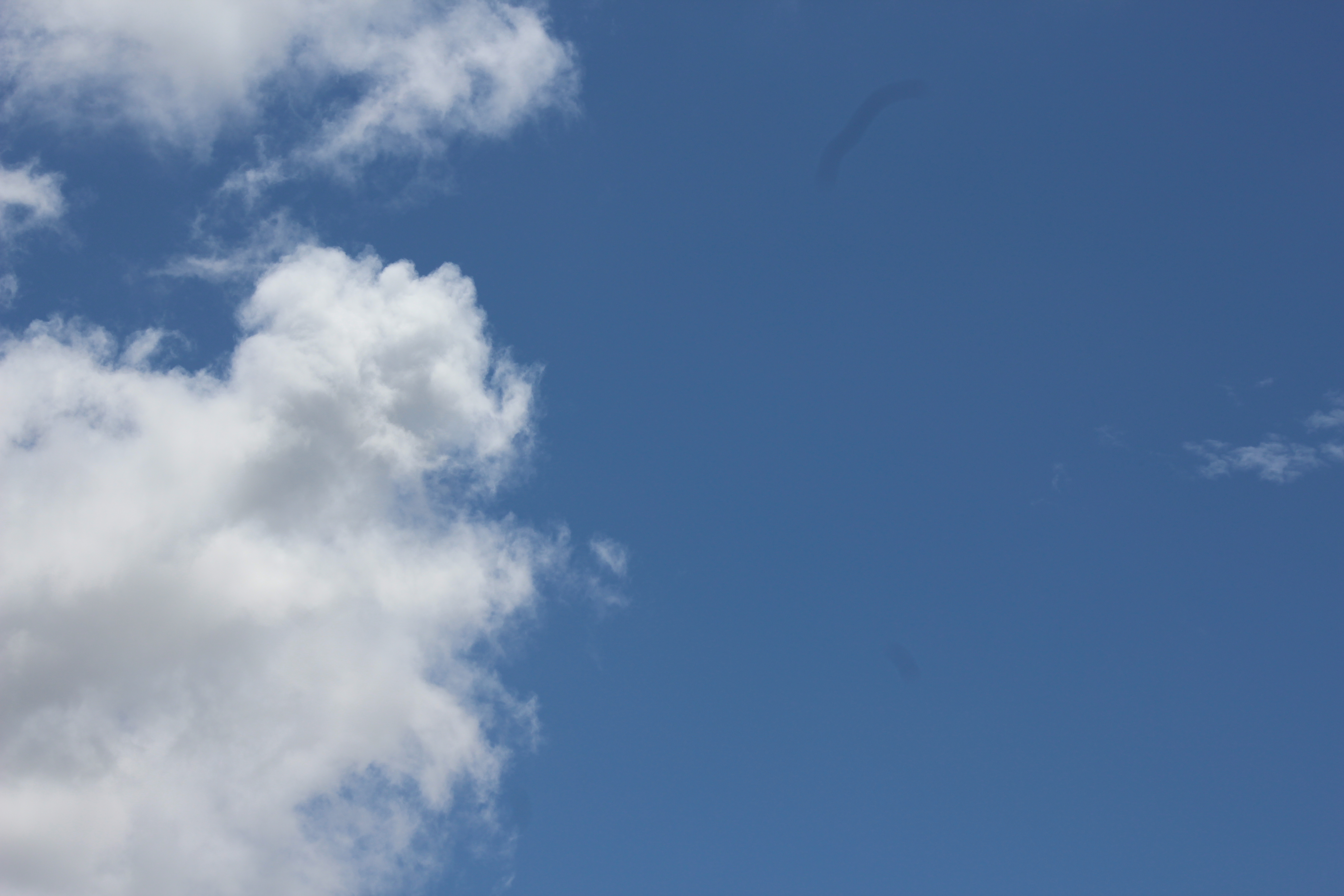

I noticed that my pictures have been showing a "worm" like blemish on my pictures recently. Can someone tell me what may be causing this?? You can see the "worm" on top of pic in the middle kind of too the right. IMG_5894.JPG

Yep.  Foreign debris on the sensor.

That is most likely a piece of dust on the image sensor.  The proper way to remove it is with a bulb blower, like those made by Rocket Blower.  Whatever you do, do not huff and puff, and blow it out with your mouth.  Your breathe is full of moisture particles.
I bought a cheap cleaning Canon cleaning kit...very basic but should i buy a better blower and swabs to clean it? I am afraid to clean it myself but to save money i would learn to do it myself.

Based on your inexperence, I would stay away from swabs, and stick strictly to the blower.  If the blower does not cure it, which i am pretty sure it will, then have it professionally cleaned.
When you use a blower, make sure to hold the camera pointing downward, so that any foreign objects all out of the body.

Does this happen no matter what lens is mounted on the camera? Have you removed the lens and tried using an air puffer to blow the body and rear of the lens clean?
I'd say hair, lint or dirt on the sensor.  Make a cursory inspection before inspecting the sensor.

I have two lens, and BOTH are showing this "worm" on it. 😞
