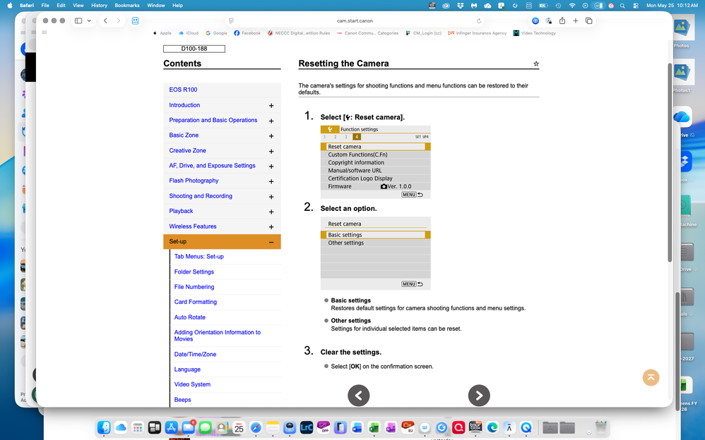

Unclear from the wording if 1. you aren't sure how to reset camera, or 2. reset doesn't work.
If it's #1:

Thank you.  I will try taking the battery out for a couple of days & try what you suggest.  Fingers crossed.
Thank you.  I can't get to the menu to try and reset the camera.  It has been suggested I take the battery out & leave for a couple of days so I'll try that & see if I can then get to the menu.  Appreciate you help.  Yep SD card not SIM.
Thank you.  Yes that sounds like what is happening "live view" and the orange light also comes on so I think that has something to do with the movie mode.  No noise when being turned on/off.
