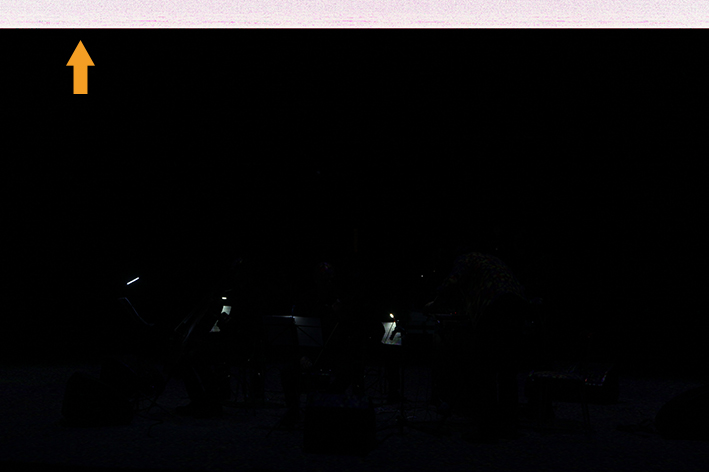

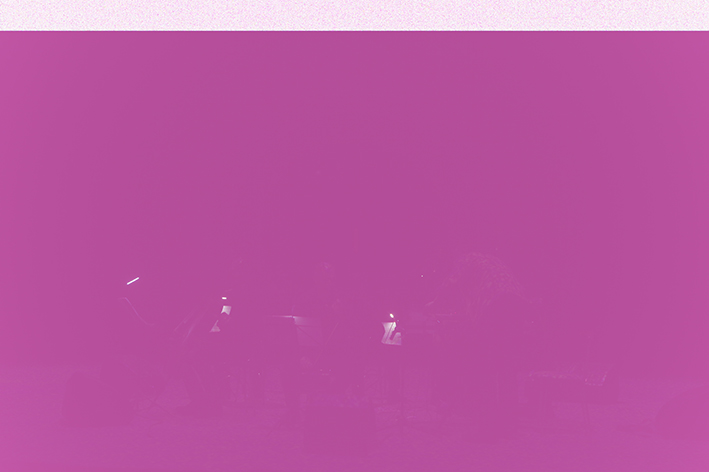

I have a problem with my 5D mark ii, one month ago during the photo shoot I mentioned that one of the photos had a horizontal white stripe at the top and just right after that shot second one was pink (all the image), I restarted the camera, took off the battery, switched it on again and it worked fine, but one week ago it started doing the same corrupted images again and more regularly than before, 5, 6 sometimes 100 images are fine after the camera restart, but in a while it starts again.

3. When the images are pink they appear pink on LCD and in Computer too (so it is not a LCD problem)

I will attach the corrupted images here to illustrate exactly what kind of problem I have.
