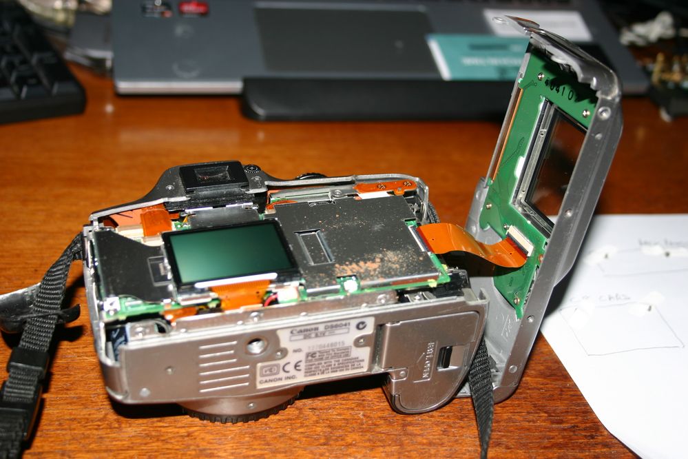

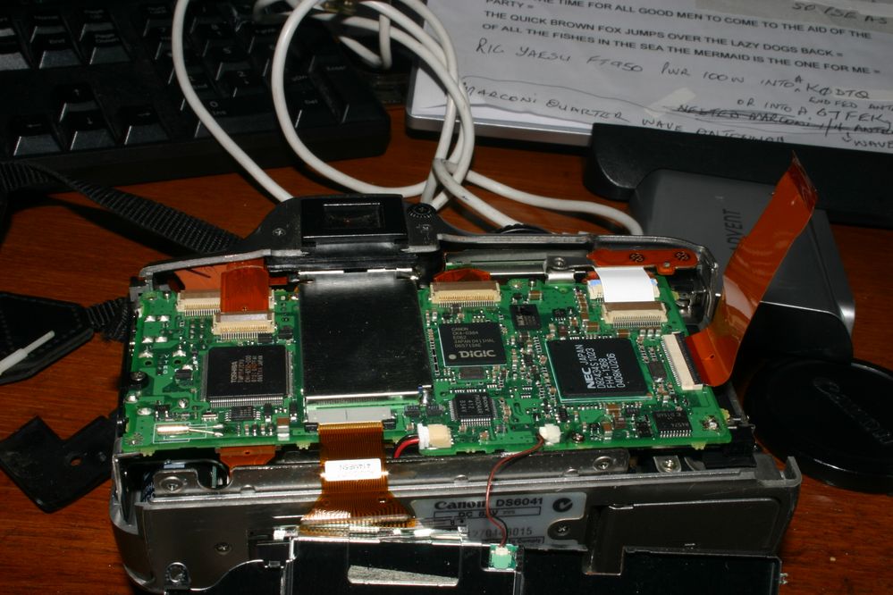

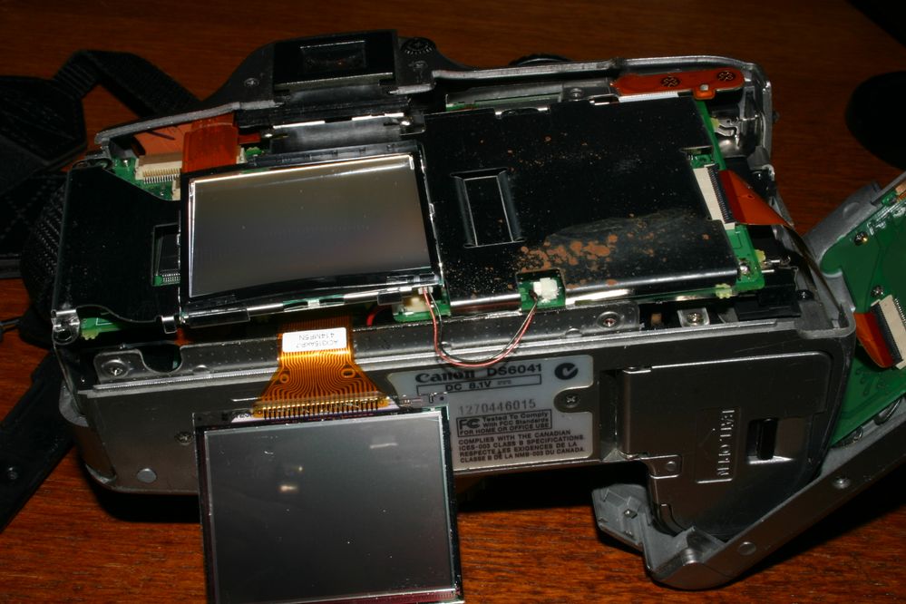

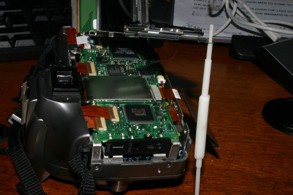

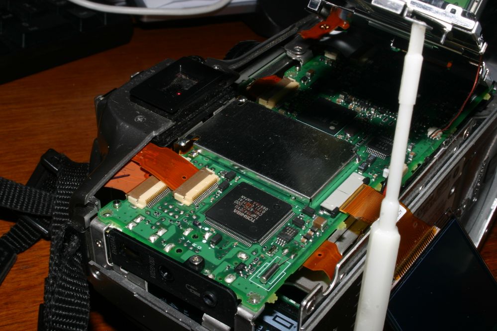

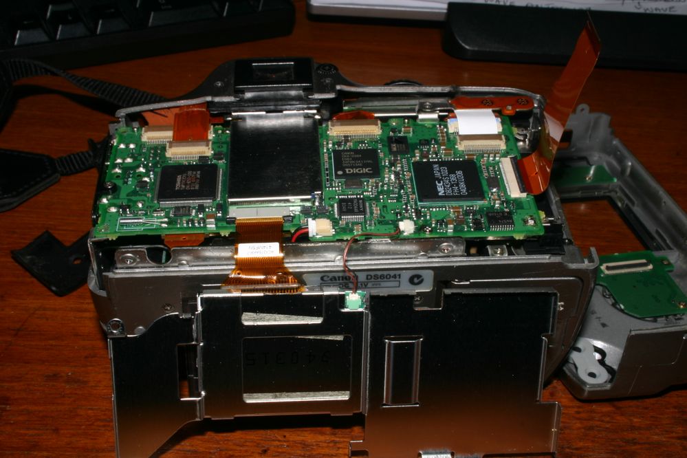

I thought I would let you know where I’ve got to with the Canon EOS 300D showing Error 99 with the following paragraphs: -

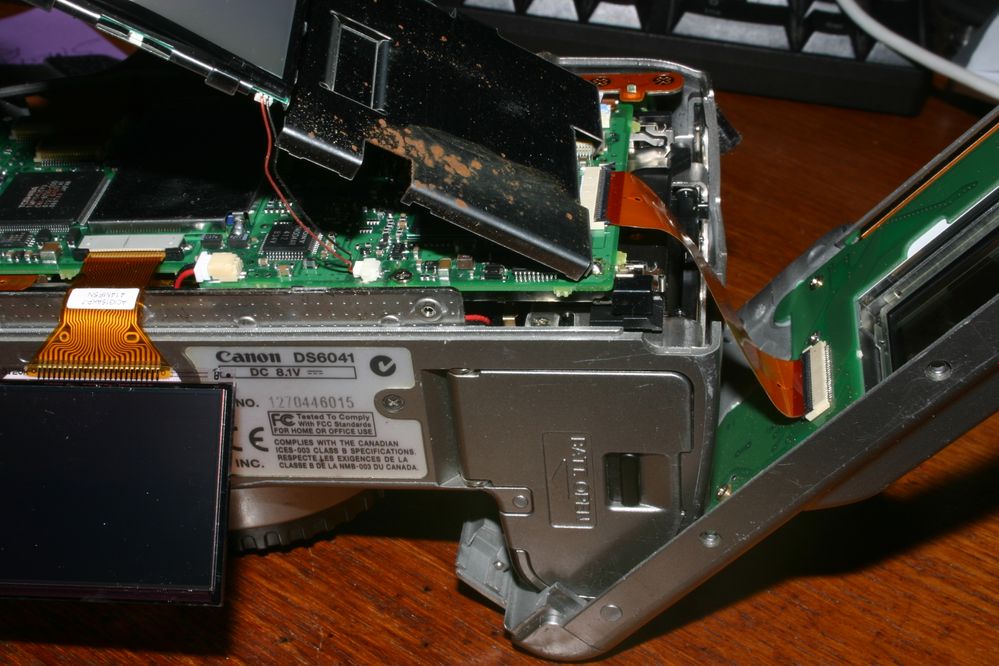

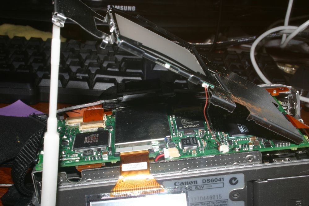

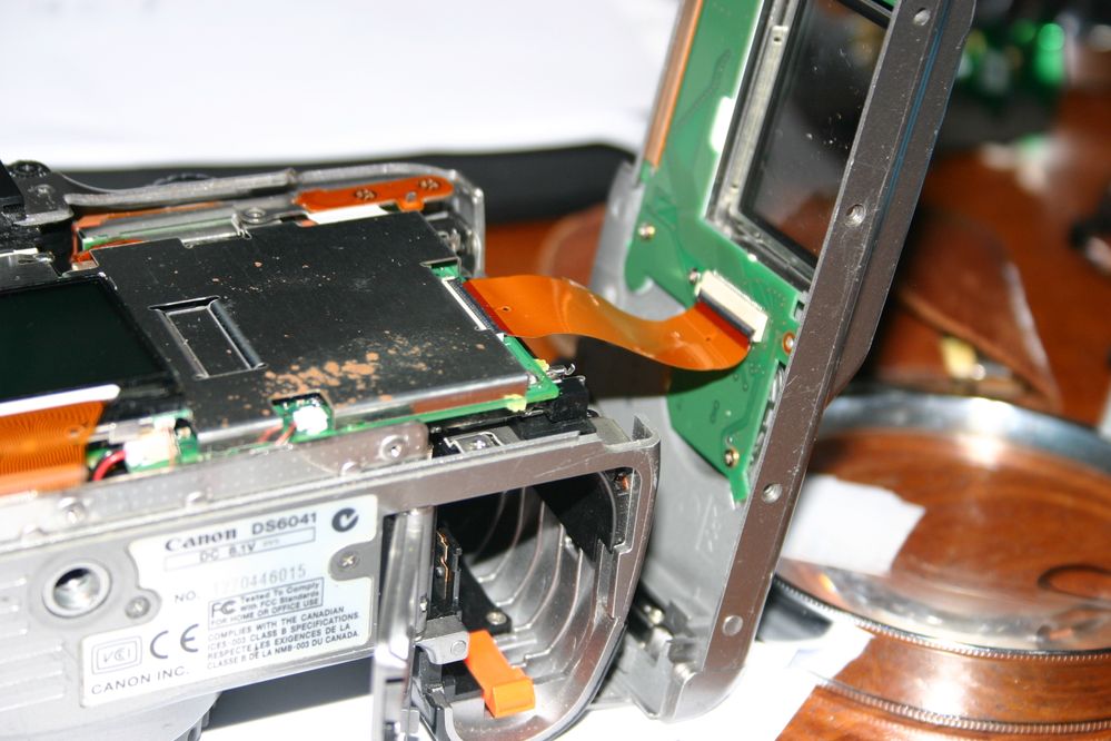

  1. I have carried out several number of tests to try and isolate the fault. The error appears after every shot, but the camera does actually take the photograph, but no review is shown on the LCD screen.  After switching the camera off and back on, the image can be viewed and therefore the picture is correctly saved to the CF and is properly exposed and in focus.
  1. I tested the camera with two different lenses (Canon EF-S 18–55mm and Sigma 70–300mm), and the same problem occurs with both. I also tested the camera without a lens attached, and Error 99 still appeared.
  1. I then opened the camera and accessed the main board. I reseated several ribbon cables, including those connected to the shutter mechanism. After doing this, the camera powered up correctly and operated as expected, however, the Error 99 still occurs after each shot.
  1. From what I can tell, the camera completes the exposure cycle but does not recognise that the cycle has finished, which suggests a fault with the internal detection (possibly a switch or signal from the shutter mechanism).
  1. So, at this stage, the camera is very close to working but still throws Error 99 every time a photo is taken. I have included some photographs of the stages of some of the areas inside the camera which I worked on.  Now that I have a good knowledge of the camera, I won’t bin it, as I feel that having had a go then at least, I am aware that perhaps some items could be used as spares if required in the future.
  1. As you said, it has certainly been a learning experience, and worth the effort. But if you recall, I still have a Canon EOS 300D which was purchased from eBay for £36 plus a delivery charge of £2.60. So, all is not lost and I can soldier on with taking perfect photographs with this second-hand camera using the 2 lenses quoted above in paragraph 2, and at 84 years of age I am sure it will last me until I die He! He!

Looks like there was some sort of water intrusion at some time based on what appears to be rust in second image.
John Hoffman
Conway, NH
Thanks for your reply. When I inspected the inside, in particular the PC board there appeared no water ingress, and I guess the rust you saw was down to a bit of condensation. As I said in my report, it does take pictures now that I have put it back together, but rather a pain in the backside having to switch it off and back on to take another picture and I am glad I have a second Canon EOS 300D. So this error 99 camera will probably be used as spares.
