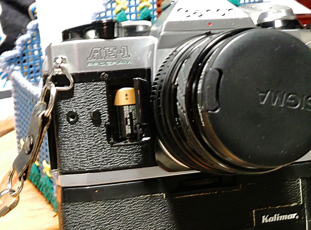

02-22-2022 10:06 PM
This is the way ours is. The battery compartment is partially hidden by the grip.
Unscrew and remove the grip.
Remove grip.
Use your fingernail or a knife to pop open the cover with the little latch.
Release cover.
Battery 🙂
Battery.
