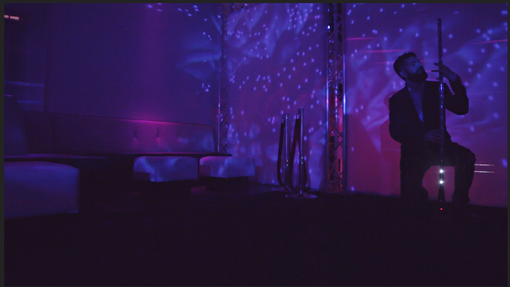

Ive come across this problema and want to understand what the issue is ..ive used my 70d in low ligth settings and a lower than 800 (640) iso ...however when i put in post i still can see grains. I thought that if you go over 800 is when you see the grains. can anyone explaine why this is happening? even when i correct my blacks to black i can still see the grainy ness and it is very annoying.
when i open up properties this what i see
File Path: /Volumes/Baejing/BTV/Clients/Mykel Reto/Files/MVI_3492.MOV Type: MPEG Movie File Size: 1.66 GB Image Size: 1920 x 1080 Frame Rate: 23.976 Source Audio Format: 48000 Hz - 16 bit - Stereo Project Audio Format: 48000 Hz - 32 bit floating point - Stereo Total Duration: 00:04:22:15 Pixel Aspect Ratio: 1.0 VR Projection: None
it was shot on a 14mm wide lense 2.8 fstop low shutter about 400-600 iso Screen Shot 2018-07-12 at 3.44.33 AM.png

Noise is inherent to every sensor and at every ISO.

If you don't boost ISO at all (base ISO or ISO 100 for your camera ... btw, ISO is really what we call "gain") you probably wont notice these tiny little "waves" on your surface (they are the "noise).  Trouble happens when you boost ISO.  This boost (really gain), amplifies the value of EVERYTHING in the shot.  So the dim subject that you boosted by increasing ISO now no longer looks dim.  But those really tiny waves that you could hardly notice... well they've turned into much bigger waves.  They're now big enough to be noticed.

Anytime you are concerned about noise and have the freedom to choose a lower ISO, your best to pick the lowest workable ISO.  Trouble is... in very low light, to get the version of the image where you don't notice the noise would require a very long exposure duration... and that would probably result in a blurry shot.  So we boost the ISO because we can deal with noise in post processing more easily that we can deal with blur in post processing.

You can use software to reduce noise.  The software mostly works by calculating the average brightness (sampling clusters of pixels to determine how bright they are) and then knocking down the values of any pixels that stand out.  But the problem is you will get strong (natural) deviation of pixel values in places that actually DO have loads of detail in the photo.  And knocking down the differences means you're actually "softening" the shot... leaving you with something less-sharp than you want.
In some better de-noising algorithms, you can SELECTIVELY deal with de-noising vs sharpening (if you sharpen an image, you're asking software to accentuate the difference between pixels... making noise even MORE noticeable.  If you de-noise an image, you're asking it to do the opposite... to minimize the difference between pixels... which does help hide the noise but also SOFTENS the image.  Basically de-noising vs. sharpening are opposites of each other.
Also in better algorithms, you can ask the software to be more aggressive about noise in shadows than in bright areas.  There are a couple of reasons why this is a good idea.  One has to do with how noise works, the other has to do with how the human eye works (which we map to something we call "gamma").
Lightroom has some fairly decent algorithms and tools to deal with noise.
In Photoshop you can do some even more powerful things by learning to create an "edge" mask (the mask looks like someone converted the photo into an ink drawing... it identifies all the contrasty areas.)    You basically duplicate the image, create the edge mask, and then de-noise the image with the mask.  This causes all the NON-CONTRASTY areas to get de-noised, but leaves the edges alone -- remember that de-noising is the opposite of sharpening.  So you don't want to de-noise edges of strong contrast or your image will look a bit soft.
In your image, you notice the noise in the violet areas on the walls.  The mask would help you isolate the de-noising to just those areas.
