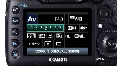

@Chrisc99 In Av & Tv Modes what would be the light meter is now the scale for Exposure Compensation (EC). It can be accessed from the LCD screen. The area highlighted in the picture is where you need to adjust it. If not already set to 0. It should be set at 0 for the correct exposure. Unless you want to add or subtract Exposure Compensation (0).
03-19-2026 03:59 PM
Looking at the LCD was all the way across to -4 having changed it to 0 it has worked.
Thank you
