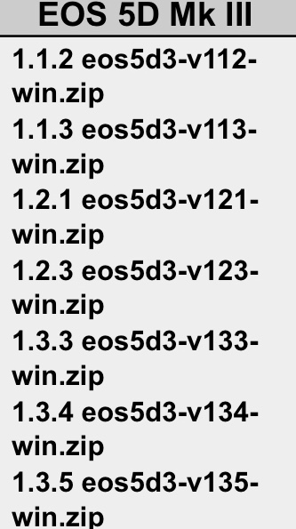

This website has downloads available for all current and older firmware versions: http://pel.hu/eoscard/
Scroll down to the bottom of that website to find all the firmware.

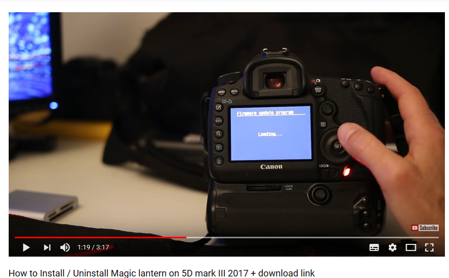

Think carefully and see if the below questions are relevant.
Have you ever loaded Magic Lantern on your 5D3 ? Or if you bought it used, do you know if the previous owner(s) have ever used the Magic Lantern on the camera ?
If positive, the bootflag loaded on the camera may haven't been removed.
Does your CF card still have Magic Lantern files on it ?
I posted a screen shot and the link relating to the ML installed on a 5D3.
https://www.youtube.com/watch?v=smQ7BwKEO60 (go to 1:19)
04-01-2018 07:17 PM
If it is the problem with the Magic Lantern boot flag. You have to copy the ML .fir back onto the CF card and let it reboot from there to remove the boot flag. (watch the video and go to 2:05 to see the proper uninstallation procedure)
If you are certain that this 5D3 has never had ML on it. Ignore my post.
