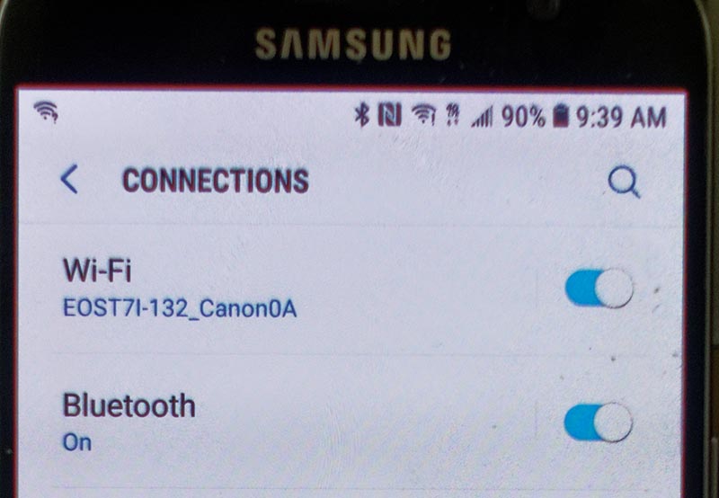

I'm trying to connect my android phone (Android 8.0.0) to my T7i using the Canon Camera Connect app. The phone shows the correct camera SSID in the listof networks, but when I try to connect to that camera network I see "Internet may not be available" although it supposedly connects to that network. But the camera never changes from "Waiting to connect". I've attached images (1) from the phone showing the camera as the current network but with the warning message, (2) from the phone showing the (supposed) connection to the camera network and (3) the camera saying that it's still waiting on a connection.

Thanks! However, on page 22 of that manual, where it says to select "Paring" , on my camera "Pairng" is disabled. Is that a clue??

Can you connect via Bluetooth? Bluetooth can automate the Wi-Fi connection process. Also, be sure to use the default camera name, do not rename it until you establish a connection.
12-22-2020 06:59 PM - edited 12-22-2020 06:59 PM
The "Pairing" that was disabled was a part of the section on "Establishing a Bluetooth Connection", so I guess the answer is that I didin't get a Bluetooth Connection established.
12-22-2020 07:19 PM
@mwr wrote:The "Pairing" that was disabled was a part of the section on "Establishing a Bluetooth Connection", so I guess the answer is that I didin't get a Bluetooth Connection established.
Was the phone looking for a Bluetooth connection, too? It would need be to connect to the camera.
12-22-2020 09:35 PM - edited 12-22-2020 09:35 PM
>Was the phone looking for a Bluetooth connection, too? It would need be to connect to the camera.<
I have no idea. I was just following the instruction step by step.
12-23-2020 02:29 AM
When you tap the network name in the phone's wireless settings, it will probably ask you for a password.
The wireless connection on the screen of your camera should give you one on the same screen that lists the SSID name.
Steve Thomas
12-23-2020 07:11 AM
>When you tap the network name in the phone's wireless settings, it will probably ask you for a password.<
No, it doesn't ask for a password.
